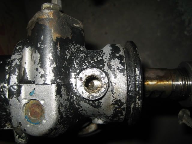

Techno Duck Posted February 10, 2007 Posted February 10, 2007 Can either of you that have the manual rack out of the car please check something for me. If you rotate the splined input shaft by hand, does the steering rack feel 'notchy' when it gets to perfectly centered? I believe the rack is centered when this happens, however the alignment notch on the toothed rack does not line up perfectly with the hole on the manual rack i have. This picture shows where i am in the 'notch' and i believe the rack is centered..but as you can see the alignment hole for the special bolt does not line up. I appreciate any help! Quote

944-Spec#94 Posted February 12, 2007 Posted February 12, 2007 Can either of you that have the manual rack out of the car please check something for me. If you rotate the splined input shaft by hand, does the steering rack feel 'notchy' when it gets to perfectly centered? I believe the rack is centered when this happens, however the alignment notch on the toothed rack does not line up perfectly with the hole on the manual rack i have. This picture shows where i am in the 'notch' and i believe the rack is centered..but as you can see the alignment hole for the special bolt does not line up. I appreciate any help! The hole is supposed to be the rack center. However any notchy feel could be from wear or some other rack problem. Manual racks clearly don't leak, but still can wear out and this might be what you feel. The manual rack in my race car and my 83 street/parts/autocross car never felt notchy. Quote
Legends21 Posted February 13, 2007 Author Posted February 13, 2007 Jon: I am going to CMP today, but I'll take a look tonight and let you know. Dale Jon: I worked the input shaft of the manual rack on my workbench. I could not detect any major difference in the feel when at center or not. Hope that helps. Dale Quote
Techno Duck Posted February 13, 2007 Posted February 13, 2007 Thanks all for your help, its much appreciated! Quote
