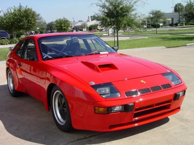

Techno Duck Posted February 12, 2007 Posted February 12, 2007 This CGT has the pins mounted right next to the front edge of each fender. This may not be a viable option if you still have headlights though. [/img] Quote
Tim Comeau Posted February 12, 2007 Posted February 12, 2007 That is one BAD A$$ looking 924! I still want to do a 1981 924 Le Mans bodied car. Someday....... Quote
Techno Duck Posted February 12, 2007 Posted February 12, 2007 Ah yea... one of my favorite cars of all time.. Quote
