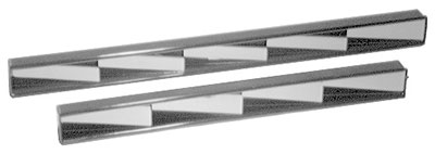

genikz Posted March 4, 2007 Posted March 4, 2007 Which rear view mirrrors do you guys suggest? I'm considering the Wink 4-pane unit (29in long, pictured in the middle). My factory mirror vibrates and is pretty much useless, so clip-ons are out of the question unfortunately. I've got no roll cage at this point, but I need better vision for HPDE's. Thanks! Quote
pixrken Posted March 4, 2007 Posted March 4, 2007 Hi Chris, I have a five panel wink and it vibrates a lot also. I just installed a homemade support brace for the center of the mirror and will let you know how well it works after I try it out next week. Quote
genikz Posted March 4, 2007 Author Posted March 4, 2007 Ken, Would you recommend the 5 panel then, vibrations aside? It seems MASSIVE at 36" wide. Quote
pixrken Posted March 4, 2007 Posted March 4, 2007 Chris, Most of the cars I seen have the five panel, the four panel should work just as well and I was originally thinking of buying the four panel. The local Kragen's where I bought mine only had the five panel in stock and is what I picked up. I also had to make a 2" extention on both sides to get the mirror away me and closer to the front windshield because of my seating position. This shouldn't be a problem if you're a taller driver and sit back a little further. Quote
