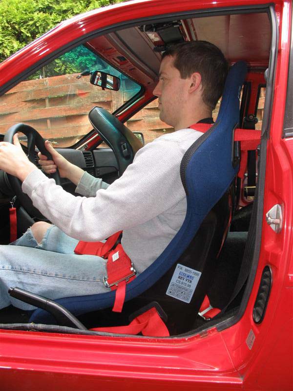

Just about ready to drill my floors... last critique needed
schwank
Recommended Posts
Posted a thread over at rennlist... since you guys have quite a bit of experience here, could you please pop over there and take a look. Let me have any comments you might think of!
I really want to get my seats mounted this week. I have a DE friday and would love to have harnesses and the sparcos installed. Thanks!

Ok Couple things.
1) You need to shave.
2) Fix that hole in your pants.
3) Are you using the stock outboard lap belt mount. This is the best place for that mount. Inside on you car needs to go through the tunnel. Things look good otherwise.
4) Shoulder harnesses seem a little low especially once you figure in a HANS which will raise the height of the shoulders straps a bit. Seeing where the holes are in the seat you may need to pull the seat pad as the harness is very close to the top of the holes. I run without a seat pad in my car and it is alot more comfortable that you would think.
Otherwise fine.
