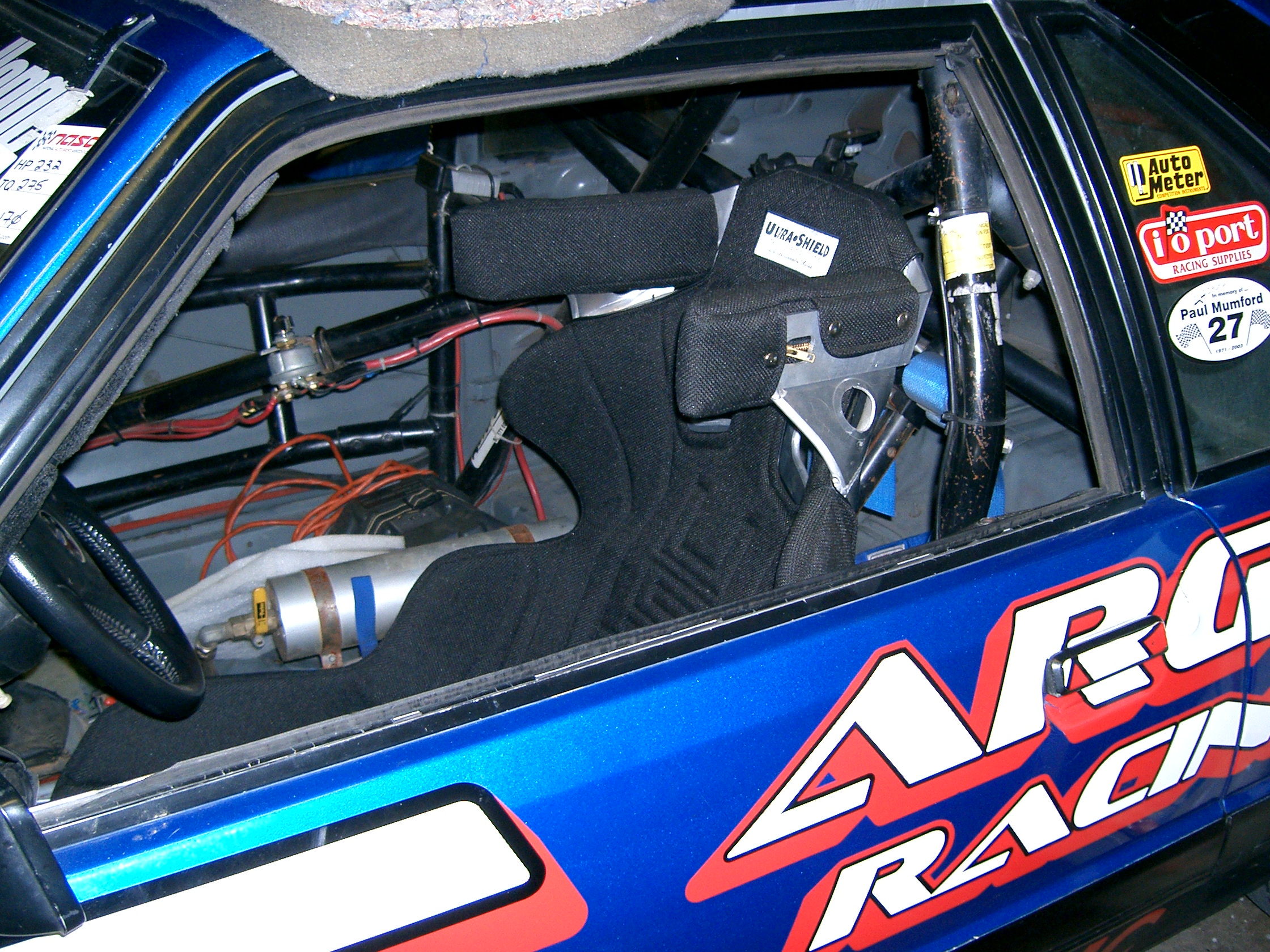

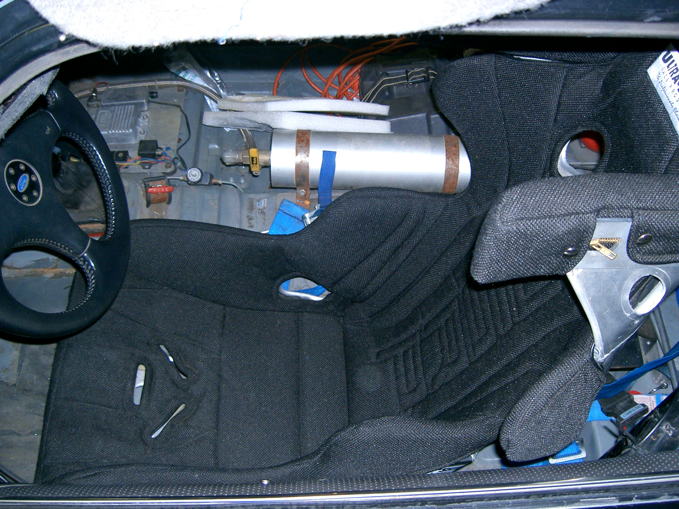

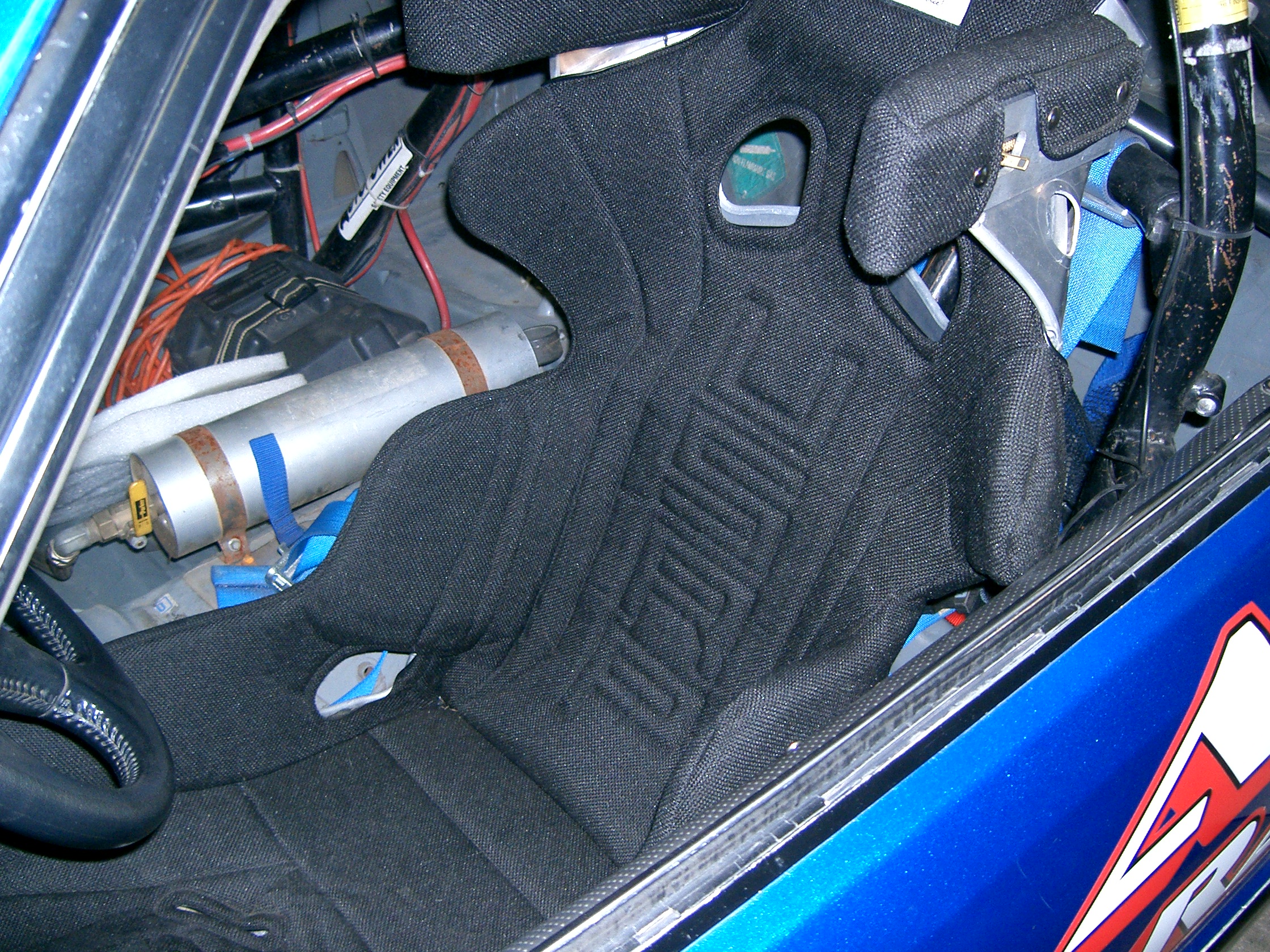

I'd like to comment on your race seat - from experience, I would only order a seat with the integrated head restraint/halo. I'll acknowledge, for me, it's a personal preference, but IMO, it's much easier to have the halo then deal with the right-side head restraint net.
Back in late 2008/early 2009, I put an UltraShield with the halo in my CMC car, and love it.
http://www.shrackracing.com/cmc-05/seat/seat-1.JPG
http://www.shrackracing.com/cmc-05/seat/seat-2.JPG
http://www.shrackracing.com/cmc-05/seat/seat-3.JPG
Keep us posted on your progress!!
