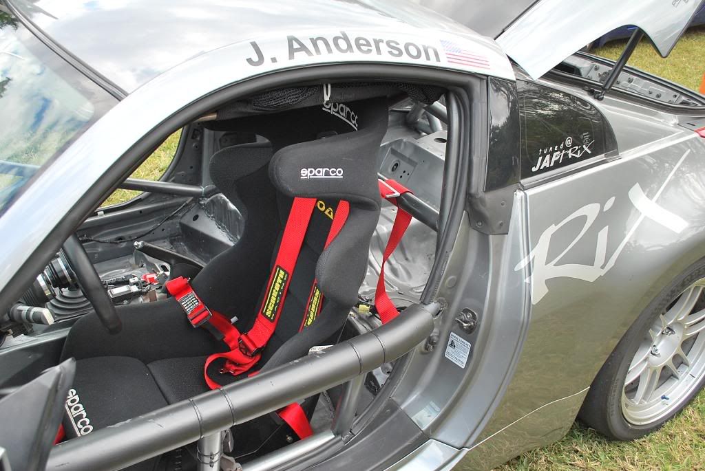

obzezzed350 Posted September 14, 2010 Posted September 14, 2010 I have a Sparco PRO-ADV in my Z. I am 6ft, 160lbs, 30-32 inch waist and its about a half an inch big, but very comfortable. Its around $750 or so Ron @ Discoveryparts.com will ship anything over $100 free via ground. Its nice because it has built in head side restraints so you wont have to run the center net. Best of luck in your Z build! Here are a few pics Quote
