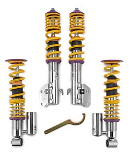

hhdinyuma 0 Posted January 15, 2014 Author Share Posted January 15, 2014 Anybody used the KW Variant 3 Coil Over's on the Twins yet. I have used KW Clubsports on my Mustang and liked them very much. The Variant 3's seem to meet the guidelines I suggested earlier. They are about $2,200.00 from Tire Rack. I believe they are made by the same company that makes AST. Most important, they should be readily available and not require any customization for our use. I think this picture is generic. I don't believe they have the reservoir attached. I might be wrong though. Quote Link to post Share on other sites
Members Emmanuel B. 0 Posted January 15, 2014 Members Share Posted January 15, 2014 Anybody used the KW Variant 3 Coil Over's on the Twins yet. I have used KW Clubsports on my Mustang and liked them very much. The Variant 3's seem to meet the guidelines I suggested earlier. They are about $2,200.00 from Tire Rack. I believe they are made by the same company that makes AST. Most important, they should be readily available and not require any customization for our use. I think this picture is generic. I don't believe they have the reservoir attached. I might be wrong though. A close friend had them on his FR-S. They're really good on track (he shaved about 2 seconds a lap at Talladega Grand Prix with just that change only over stock). They're extremely harsh and horrible on the street though, hence the reason I decided against them for MY TT car. Here's 'a pic of FR-S KW V3. (No reservoir) http://www.garagefrs.com/kw-v3-coil-over-suspension/ Quote Link to post Share on other sites
hhdinyuma 0 Posted January 15, 2014 Author Share Posted January 15, 2014 Sounds like they should be included on the short list then as a candidate for a SPEC86 Shock/Spring package. I like that they are double adjustable and can still remain as a 3 point shock. Anyone using other similar packages on the Twins want to weigh in? Does anyone have info on what might be available from TRD? Just curious since they could/should be considered as a possible title sponsor down the road maybe. Quote Link to post Share on other sites
Members Emmanuel B. 0 Posted January 15, 2014 Members Share Posted January 15, 2014 Sounds like they should be included on the short list then as a candidate for a SPEC86 Shock/Spring package. I like that they are double adjustable and can still remain as a 3 point shock. Anyone using other similar packages on the Twins want to weigh in? Does anyone have info on what might be available from TRD? Just curious since they could/should be considered as a possible title sponsor down the road maybe. I concur - ADD TO LIST. No shocks from TRD yet. Just lowering springs and sway bars (rebranded Eibachs). The GT-86 race cars being sold by Toyota are using Ohlins R&T. I personally use Yellow Speed Dynamic Pro Sport - http://yellow-speed.com/dynamic-pro-sport.php (but that's because I wanted some comfort for the 300 days of the year I'm not at the track after experiencing those KW V3s) plus I wanted something with camber plates included. Haven't measured the performance gain compared to KW V3s, though I was 3 seconds faster on my one hotlap at Road Atlanta in Dec. compared to Sept. with no changes to the factory settings and stock car. (Didn't bother going out for the rest of the weekend because of the weather and helping out with final race weekend stuff.) Can you explain how that's still a 3pts? I thought that's a +5. Quote Link to post Share on other sites
kbrew8991 0 Posted January 15, 2014 Share Posted January 15, 2014 shock at +3, springs for +2, total of 5. Probably why y'all aren't quite on the same page. Quote Link to post Share on other sites
hhdinyuma 0 Posted January 15, 2014 Author Share Posted January 15, 2014 shock at +3, springs for +2, total of 5. Probably why y'all aren't quite on the same page. What Ken said...These shocks meet the following portion of the rules: E. SUSPENSION: 3) Non-BTM or modified/re-valved shocks/struts/dampers +3 (all others)(springs not included) 5) Non-BTM or modified coil springs, leaf springs/spacers/brackets, or torsion bars +2 The shocks themselves are only 3 points but of course adding the springs will make the total package 5 points. Sorry if I made it confusing. Since they have only 2 adjustments, no external reservoir and less than 40MM shaft diameter they meet the requirements of 3) above. I haven't actually checked the shaft diameter but I am pretty sure they are less than 40MM. My KW Clubsports measure 22.5MM. Quote Link to post Share on other sites
Members Emmanuel B. 0 Posted January 16, 2014 Members Share Posted January 16, 2014 shock at +3, springs for +2, total of 5. Probably why y'all aren't quite on the same page. What Ken said...These shocks meet the following portion of the rules: E. SUSPENSION: 3) Non-BTM or modified/re-valved shocks/struts/dampers +3 (all others)(springs not included) 5) Non-BTM or modified coil springs, leaf springs/spacers/brackets, or torsion bars +2 The shocks themselves are only 3 points but of course adding the springs will make the total package 5 points. Sorry if I made it confusing. Since they have only 2 adjustments, no external reservoir and less than 40MM shaft diameter they meet the requirements of 3) above. I haven't actually checked the shaft diameter but I am pretty sure they are less than 40MM. My KW Clubsports measure 22.5MM. Right. Yes, they are less than 40mm. I've always calculated them as +5 since I'd never expect anyone to buy that and replace springs with stock. Whew! I've been off all day, easily confused. I'll blame it on SharePoint 2013 setup kicking my butt this week at work. OK. Back to the conversation. I can't think of a more affordable suspension set at this level, except the made it Taiwan sub $1k options... but those are not designed for dedicated track use. Quote Link to post Share on other sites
Sterling Doc 0 Posted January 16, 2014 Share Posted January 16, 2014 Agreed. While in theory the RCE Tarmac 2's (track-tuned KW's) or the Clubsports would be superior on the track, the V2's would seem to be the best combination of cost & wide availability. Spec Z uses KW's, which is a good sign. Definitely need some sort of coilovers for corner weighting. Eventually, a spring rate will need to be spec'd, and this may well not be the off-the shelf V2 rates. Springs are cheap to replace, though. Gutting cats? For a pure race car, a full spec exhaust would be nice, though this works out less well in PT. Again, well see what happens with classing. For weight issues, you can always ballast back to PT legality. Lighter is cheaper when it comes to consumables, and ='s free speed. We don't know how light these cars can reasonably get, but a min race weight around 2,650 would be nice. Quote Link to post Share on other sites
