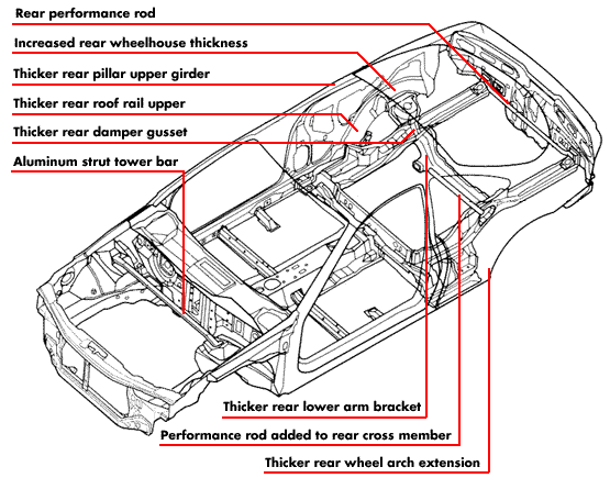

SPiFF Posted January 27, 2004 Posted January 27, 2004 I am still waiting for someone to show me where dimensionally a ITR & a 3rd gen. GSR/RS/LS are different. They ARE different. Now 20 years from now when Type-R parts are hard to find and tubs have all been wrecked or stolen, we might consider allowing H2 ITRs to be built out of other Integra parts. Until then I would hope we consider the ITR to be different then the other Integras. Sounds like too big of a hole in the rules to me. Quote
civicrr Posted January 27, 2004 Posted January 27, 2004 Spiff, Nice work. Good info. You showed that there are structural differences in the car. Differences which benefit the ITR & put the GSR/RS/LS chassis at a disadvantage. (Personally, I think the addition of a good cage will negate most of those advantages.) We are still discussing trim levels of the same car. I still haven't been shown where 'dimensionally' it is different. Is there a difference in wheelbase, track, chassis length or width? How does using a chassis other than a ITR give me a performance advantage? The wording on this section of the rules has not been changed from the original version published in the ECHC in 2002. The literal meaning, as laid out, means it is legal. It seems to me that real ITR's are already pretty rare compared to the regular Integra. Lets assume that we do change it. What happens to those who already did the swap? What happens to those who are under construction but miss the cutoff? What happens those who don't do it in season 2xxx & next season it is legal? Someone tell how this is a fair rule to change. Quote
