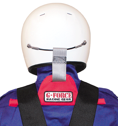

JCraven Posted December 30, 2007 Share Posted December 30, 2007 Here are some pictures or some neck restraints out there, I'm sure the HANs is SFI 38.1 certified, not sure of the others but there are definitely some extra cords and stuff that could get tangled in a roll over. http://www.racingjunk.com/post/819211/Hans-Device-with-Quick-Disconnects.html http://www.speedbrigade.com/forums/showthread.php?t=468 http://www.rx7club.com/attachment.php?s=a5e3fdb61c6cb53edeb2c7ea43f28a46&attachmentid=82352&d=1100752927 I think the Isaac one looks cleaner actually even if it doesn't meet the extra release requirement. http://www.isaacdirect.com/ GF too but it is getting pulled off the market. http://www.rx7club.com/attachment.php?s=a5e3fdb61c6cb53edeb2c7ea43f28a46&attachmentid=82362&d=1100755663 Link to comment Share on other sites More sharing options...
FlyingDog Posted December 30, 2007 Share Posted December 30, 2007 Joe, RX7club doesn't allow hotlinking. Link to comment Share on other sites More sharing options...
